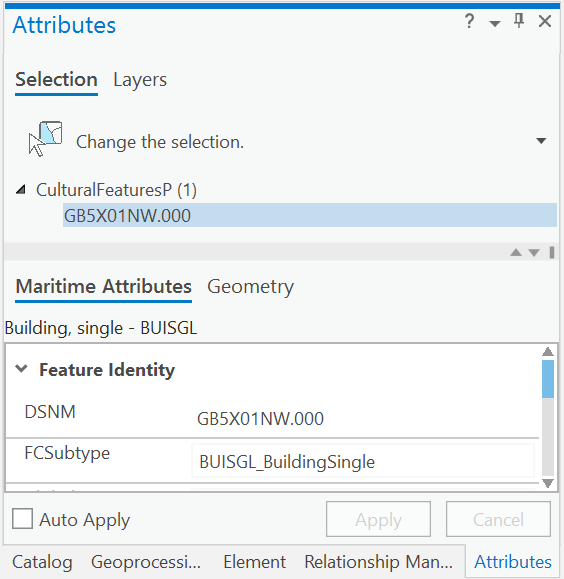

Use the Attributes pane to review and edit feature attributes in logically organized groupings. The Maritime Attributes tab appears in the Attributes pane when an S-57 feature from a maritime database is selected.
Attributes pane with Maritime Attributes tab visible

  4. On the Maritime S-57 tab, in the Selection group, click Attributes .
    The Attributes pane appears.
  5. On the Selection tab, click the Select one or more features drop-down arrow and choose a selection method.
  6. If you choose maritime features from an S-57 geodatabase, the Maritime Attributes tab appears with the following attribute categories:
