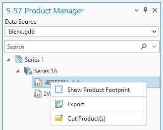

Context menu in the S-57 Product Manager pane

Move products
Products can be moved from one series to another using the Cut Product(s) option from the context menu to cut one or more products from one series and the Paste Product(s) option to paste them to another series.

View product footprint
You can select a product in the S-57 Product Manager pane to view its footprint on the map. When viewing product footprints, the footprints are added to the Product Footprint group layer and subgroups are created for each product if they do not currently exist on the map. You can turn the footprint layers off and on in the Contents pane.

  6. In the S-57 Product Manager pane, right-click the product with the footprint you want to view and click Show Product Footprint.
    The product footprint is added to the Product Footprint group layer and the footprint is shown on the map.

  6. In the S-57 Product Manager pane, right-click the product that you want to export and click Export.
    The Export Geodatabase to S-57 tool opens in the Geoprocessing pane and the Source Geodatabase, S-57 Product, and Output Location parameters are populated with information from the product selected in the S-57 Product Manager pane.
