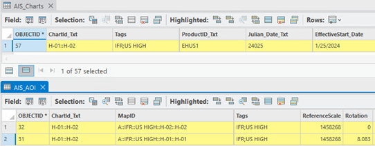

  • The Charts Table parameter can be used with the AIS_Charts table from the AIS geodatabase schema.
  • Populate the ChartId_Txt field in the AIS_Charts table with a list of areas of interest (AOIs) from the same chart product into one grouping, for example, H-01::H-02.
  • The ChartId_Txt field in the AIS_AOI table must match the value in the AIS_Charts table for each AIS_AOI feature to include in a chart product summary tabulation.
  • The Tags field values in AIS_Charts and AIS_AOI should match for corresponding data. Tags can be used to distinguish chart series such as IFR, High, Low, and VFR, and are used as selection criteria based on Tag values set in the Summary Table preference.
  • The following image shows an example of a populated AIS_Charts table row with its two corresponding AIS_AOI feature rows:
    AIS_Charts table row with corresponding AIS_AOI feature rows populated

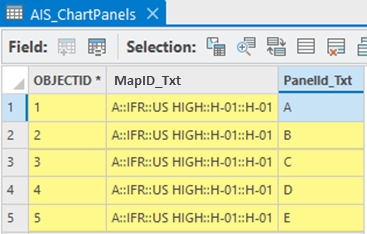

  • If you select the Has Panels option for the Summary Table preference, you must populate the AIS_ChartPanels polygon feature class with panel geometry and populate its MapID_Txt field with the value of its corresponding AIS_AOI and its PanelId_Txt field with the panel ID.
    The following image shows an example of a populated AIS_ChartPanels table's rows:
    AIS_ChartPanels table with rows populated
