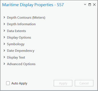

    The Maritime Display Properties pane appears with the title of the selected layer.
    Maritime Display Properties pane with the name of the selected layer

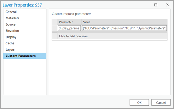

    The Maritime Display Properties pane first populates using the selected Maritime Chart Service layer's default values from the service. These default values are stored in the Custom Parameters settings in the Layer Properties pane and are used the next time the Maritime Display Properties pane is accessed.
    Custom parameters in the Layer Properties pane

Each change applied to the display properties of a maritime layer is stored in the Custom Parameters settings in the Layer Properties pane. These settings are saved with the project and used to populate the Maritime Display Properties pane when the project is opened again.
