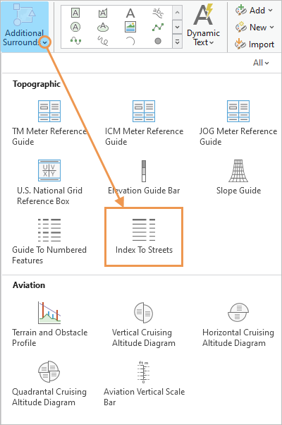

  2. Click the Insert tab.
  3. Click the Additional Surrounds drop-down arrow and click Index To Streets in the Topographic group.
    Index To Streets surround element in the Additional Surrounds gallery
  4. Click the layout where you want to insert the element.
    The Index To Streets element is added to the layout.
