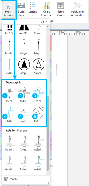

  2. Click the Insert tab.
  3. Click the North Arrow drop-down arrow and choose a north arrow from the Topographic group.
  4. Click the layout where you want to insert the topographic north arrow.
    The topographic north arrow is added to the layout and remains active.

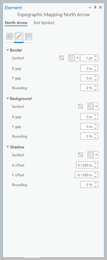

  4. In the Element pane, click the Display tab to configure the element's display settings.
    1. Configure the element's border in the Border section.
    2. Configure the element's background in the Background section.
    3. Configure the element's shadow in the Shadow section.
      Element pane with Display tab active and Border, Background, and Shadow sections expanded

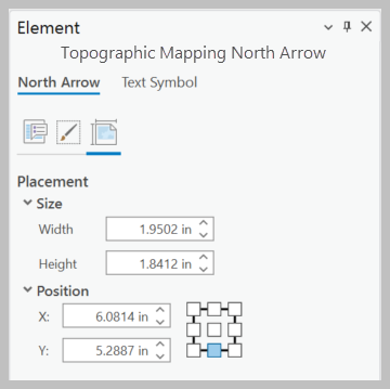

  5. In the Element pane, click the Placement tab to configure the element's placement options.
    1. Specify the element's size.
      Resizing is unavailable if the Draw To Specification check box on the Options tab is checked.
    2. Specify the element's position.
      Element pane with Placement tab active and Size and Position sections expanded
    These settings can also be set from the element's contextual tab in the Size & Position group.
