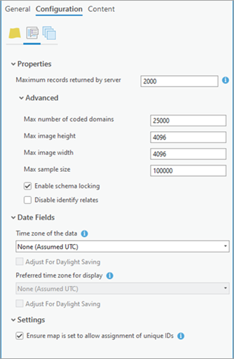

  4. Optionally, click Configure Parameters to configure more properties.
    Configuration tab in the Share As Web Layer pane
