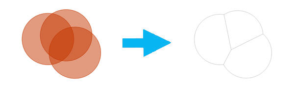

Removes overlap between two or more areas to form adjacent boundaries.
插图
Remove Overlap tool illustration

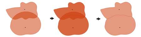

  • The Center Line option in the Method parameter creates a border that evenly distributes the area of overlap between polygons. For example, if two polygons overlapped, this method would draw a straight line from each intersection and split the two areas in half. Center Line is the simplest method compared to the more complex Grid and Thiessen options.
    Center Line method
  • The Grid option in the Method parameter removes overlap by creating a grid of parallel lines used to find a natural division between two polygons.
    Grid method
  • The Thiessen option in the Method parameter removes overlap between two or more trade areas using straight lines to divide the area of overlap. This method uses a series of geometric functions to create nonoverlapping trade areas.
    Thiessen method
