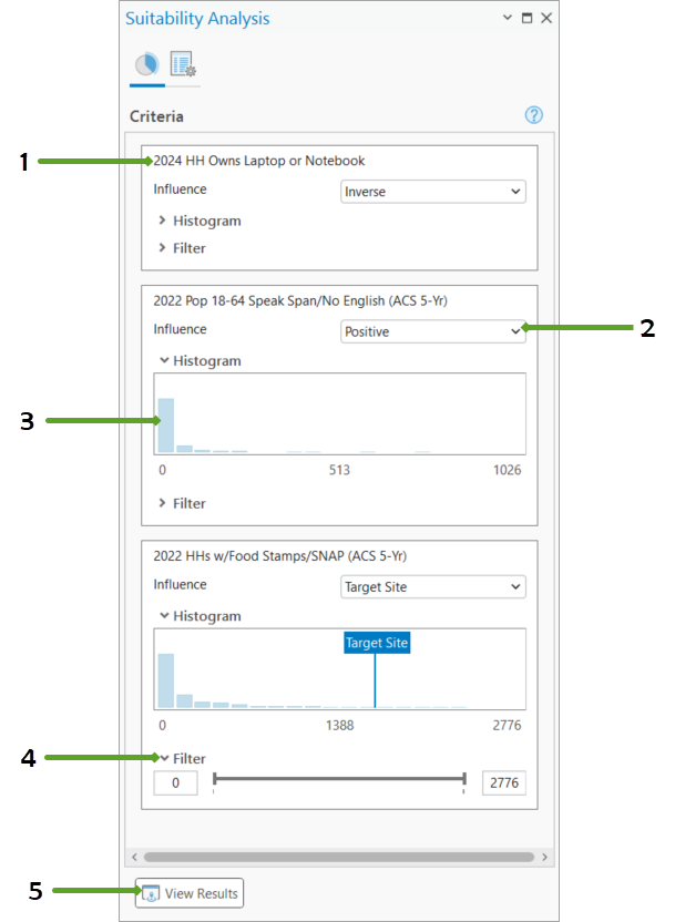

Criteria
The Criteria tab has options to modify the criteria, such as changing the calculation type, the influence, and the minimum and maximum value range.
Suitability Analysis pane Criteria tab
Criterion name
The name of the criterion.
Influence setting
This displays the influence of your criteria using the options: positive, inverse, ideal, or target site. By default, the influence for each suitability criterion is set to positive if no target site is set. If a target site is set, the influence defaults to the target.
Histogram
This displays the distribution of criteria values. The ideal value or target site value, if one is set, is displayed on the distribution.
Filter
Adjust the slider handles to define the minimum and maximum values included in the analysis or enter values manually.
5
View Results
Click this button to open the Results pane.

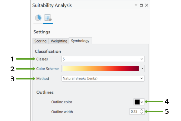

Symbology
A subset of ArcGIS Pro symbology is provided on the Settings tab of the Suitability Analysis pane. You can customize the appearance and construction of your suitability analysis layer using parameters that will persist through changes to your suitability analysis.
Suitability analysis symbology
Number of classes
The number of data groupings symbolized by color in your output data.
Color scheme
The range of colors that will be used to represent your output data. The selected color scheme will persist when change is introduced.
Classification method
The classification method used for classifying numerical fields for graduated symbology. See below for detailed descriptions of classification methods.
Outline color
Set the outline color for polygons in the suitability analysis layer.
5
Outline width
Set the outline width for polygons in the suitability analysis layer.
