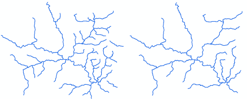

Generates a simplified hydrographic line network for display at a smaller scale. The resulting hydrographic network maintains the main arteries while thinning less significant features based on hierarchy, length, and spacing between features.
插图
Before and after illustration of the thin hydrology lines process
Stream network before and after using the Thin Hydrology Lines tool
