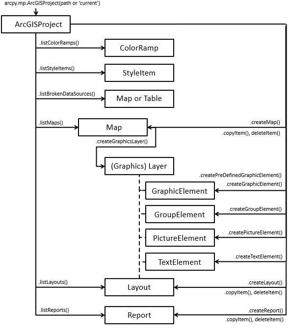

The following diagram illustrates, along the left side, the use of list functions for navigating and referencing the objects in a project. The diagram is only an example and does not display a complete set of objects and list methods.
An example ArcGISProject object model diagram illustrating the use of list and create functions.
The diagram above, along the right side, also illustrates many of the create functions. For example, you can use createMap to create a Map object, createLayout to create a Layout object, or createReport to create a Report object.
