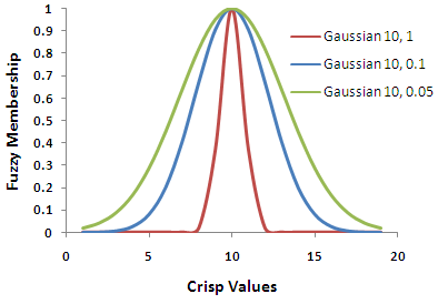

The inputs to the equation are \(f1\), the spread, and \(f2\), the midpoint. Increasing the spread causes the fuzzy membership curve to become steeper.

Fuzzy Gaussian graph
Variations of the Fuzzy Gaussian membership function.
