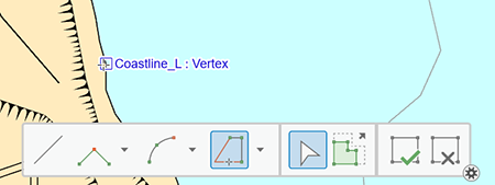

    • If you are creating a geometry for a line feature or a polygon boundary, use the Trace tool to ensure that the reference geometry coincides with the associated line feature.
      Learn more about creating segments by tracing other features
      Construction toolbar with the Trace tool highlighted and Coastline_L feature vertex selected on the map
