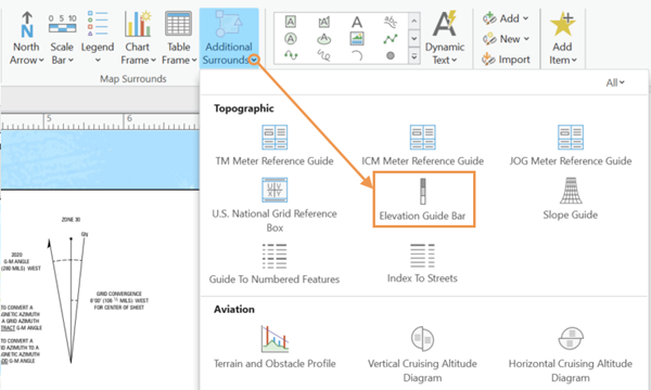

  3. In the Map Surrounds group, click the Additional Surrounds drop-down arrow and choose Elevation Guide Bar.
    Elevation Guide Bar element in the Additional Surrounds gallery

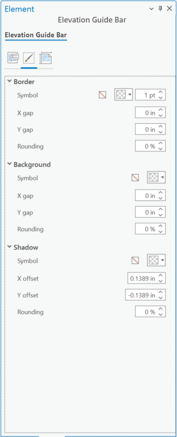

  6. Click the Display tab and set the element's appearance:
    1. Configure the element's border in the Border section.
    2. Configure the element's background in the Background section.
    3. Configure the element's shadow in the Shadow section.
      Element pane with the Display tab active and border, background, and shadow sections expanded

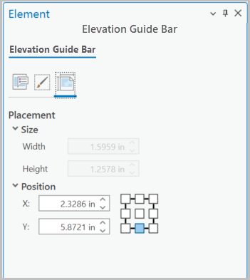

  7. Click the Placement tab and configure the element's placement:
    1. Specify the element's size.
      Resizing is unavailable if the Draw To Specification check box on the Options tab is checked.
    2. Specify the element's position.
      Element pane with the Placement tab active and size and position sections expanded
