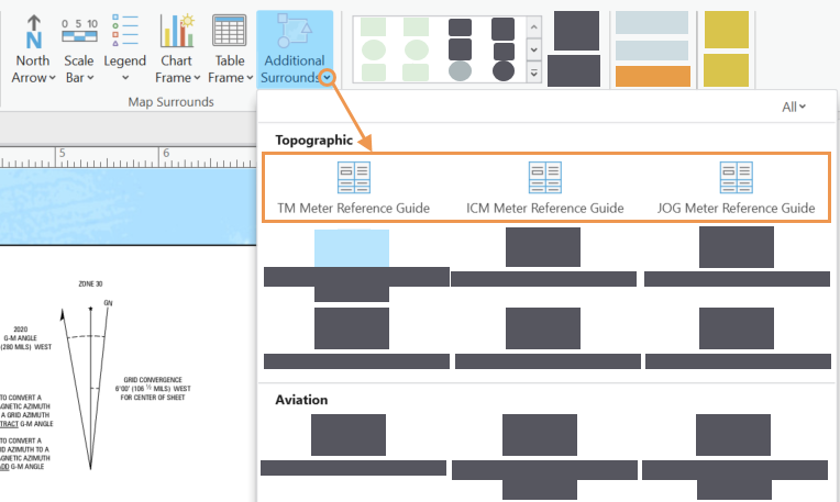

  3. In the Map Surrounds group, click the Additional Surrounds drop-down arrow and choose a meter reference guide from the Topographic section.
    Meter reference guide elements in the Additional Surrounds gallery
  4. Click an insertion point in the active layout to place the new Meter Reference Guide element.
The Meter Reference Guide is added to the layout and remains selected.

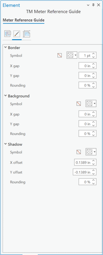

  4. In the Element pane, click the Display tab to set the element's appearance:
    1. Configure the element's border in the Border section.
    2. Configure the element's background in the Background section.
    3. Configure the element's shadow in the Shadow section.
      Element pane for Meter Reference Guide element with the Display tab active

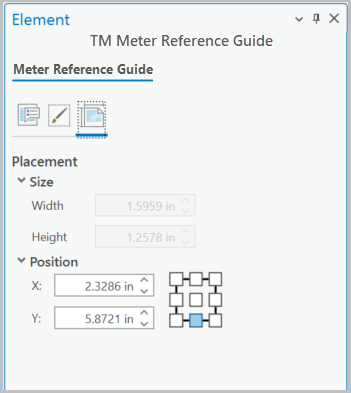

  5. In the Element pane, click the Placement tab to set the element's placement options.
    1. Specify the element's size.
      Resizing is unavailable if the Draw To Specification check box on the Options tab is checked.
    2. Specify the element's position.
      Element pane for Meter Reference Guide element with the Placement tab active
    These settings can also be set from the element's contextual tab in the Size & Position group.
The element is configured as specified. You can continue to modify it or the layout as necessary.
