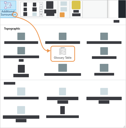

  3. Click the Additional Surrounds drop-down arrow and click Glossary Table in the Topographic group.
    Glossary Table element button in the Additional Surrounds gallery
  4. Click the layout where you want to insert the element.
The element is added to the layout.
