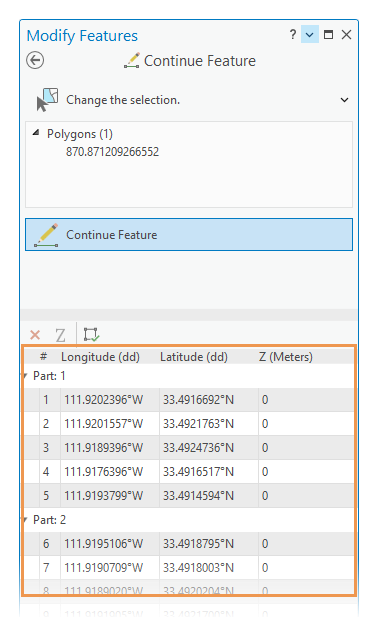

    The selected feature appears highlighted in the map with vertex handles. By default, project settings symbolize the first vertex in green and the last vertex in red.
  5. Right-click the part header for the hole in the geometry properties table, and click Delete Part .
    Tip:
    Right-click the part header, and click Pan to part if the feature is not in the current view.
    Geometry properties table
  6. Click Finish on the construction toolbar, or press the F2 key.
