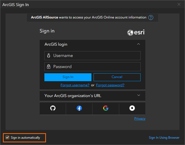

Sign in
The first time you use ArcGIS AllSource, you sign in with the credentials of your ArcGIS Online or ArcGIS Enterprise organization. After that, you are signed in automatically.
Portal Sign-in dialog box highlighting Sign in automatically
In ArcGIS AllSource, the sign-in menu is available on the start page and at the top of the application window. If you have more than one account, you can sign out of one and in to another to access content from a different portal or share items to a different portal.

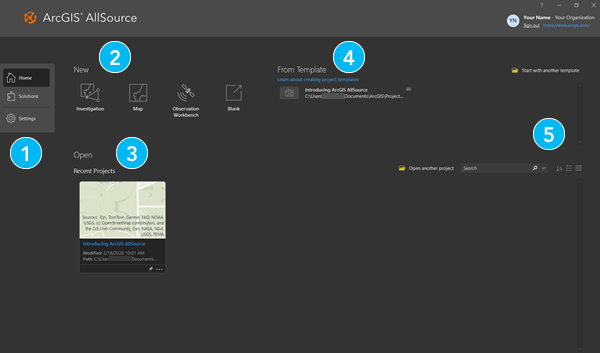

Home page
On start up, ArcGIS AllSource opens to the Home page. The Home page is where you will create projects, open projects, and open templates.
start page with a recent project
Element
Description
1
Navigate between the Home and Solutions page with the start menu. Change application properties and modify default behavior with Settings .
2
Click a default template to start a new project.
3
Click a recent project to open it. To open a project that's not in the list, click Open another project .
4
Click a recent template to start a new project from a custom template. To start a new project from a template that's not in the list, click Open another template .
5
Click List or Tiles to display projects according to your preference.

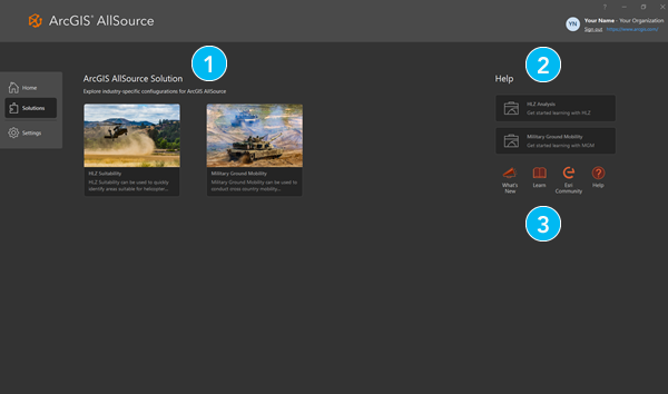

Solutions page
The Solutions page holds templated projects ready to begin a new workflow. These solutions can be used in both connected and disconnected environments with help documentation and application resources to help get started.
solutions page breakdown
Element
Description
1
2
Click a card to open the associated help.
3
Learn about ArcGIS AllSource workflows, join discussions in the Esri Community, and launch the local help system.

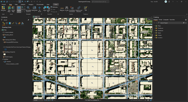

Projects
In ArcGIS AllSource, a project is a body of related work that may include maps, scenes, layouts, and connections to resources such as system folders and databases. Project files have the extension .asrx. By default, a project is stored in its own folder along with an associated file geodatabase and toolbox.
ArcGIS AllSource project with map view open

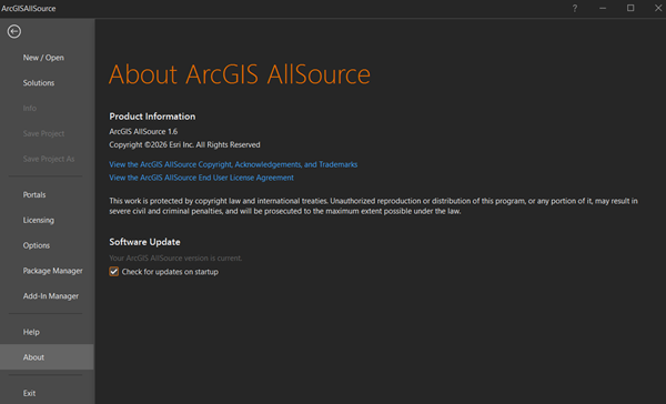

Settings
On the Settings tab , you can configure and manage the application. In an open project, the settings can also be accessed from the Project tab on the ribbon.
Settings-backstage
Tab
Description
New
Create a project.
Open
Open an existing project.
Solutions
Open the Solutions page.
Info
View info for the current project.
Save Project
Save the current project.
Save Project As
Save a copy of the current project file (.asrx).
Portals
Manage portal connections and set the active portal.
Licensing
View license information, authorize ArcGIS AllSource to work offline, and change the license type.
Options
Access project and application options to configure ArcGIS AllSource.
Package Manager
Manage environments and packages for Python, R, and system libraries.
Add-In Manager
Install add-ins to customize the application.
Help
Open the help system.
About
View information about your ArcGIS AllSource version.
Learning Resources
Access quick-start tutorials, tutorial series, and other learning resources.
Exit
Close the application.
ArcGIS AllSource Settings page

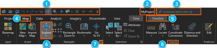

Ribbon
A horizontal ribbon at the top of the application window organizes functionality in a series of tabs. Some tabs (core tabs) are always present. Others (contextual tabs) appear when the application is in a particular state. For example, a Timeline contextual tab appears when a timeline is active in the application.
ArcGIS AllSource ribbon with Timeline open and Map tab selected with marked controls.
Element
Description
1
The Quick Access Toolbar has commonly used commands.
2
The name of the project appears at the top of the application.
3
Command Search helps you find and run commands.
4
Core tabs, such as the Map tab, organize functionality. When a tab is selected, its associated tools and buttons appear on the ribbon.
5
Contextual tabs, such as the Timeline tab, appear when the application is in a state appropriate for their use.
6
Buttons and tools run commands. For example, you use the Explore tool to navigate maps and scenes and to identify map features.
7
Dialog box launchers open panes or dialog boxes with more functionality.
8
Groups organize related commands on a ribbon tab.
ArcGIS AllSource ribbon elements

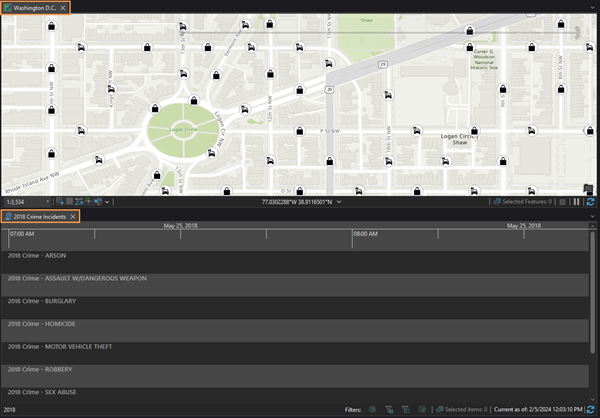

Views
Views are windows for working with maps, scenes, timelines, layouts, tables, charts, the catalog, and other representations of your data. Several views can be open at the same time.
Map and timeline views open in ArcGIS AllSource

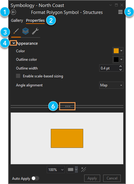

Panes
A pane is a window that displays the contents of a view (the Contents pane), the items in your project or active portal (the Catalog pane), or commands and settings for an area of functionality (the Symbology pane, the Geoprocessing pane, and so on).
Panes provide functionality that may not be available on the ribbon. Panes may have rows of text tabs and graphical tabs to organize functionality. Some panes have multiple pages.
Symbology pane with marked pane controls.
Element
Description
1
Some panes have multiple pages of functionality.
2
Text-based primary tabs, such as Gallery and Properties, partition functionality.
3
Graphical secondary tabs partition the functionality of a primary tab.
4
Expanders are small arrows that you click to show or hide settings.
5
The Menu button has additional commands.
6
Handles allow you to resize areas of a pane by dragging.
The Contents and Catalog panes are usually open in a project. Other panes appear in response to commands or actions. For example, when you click Locate on the Map tab on the ribbon, the Locate pane appears.

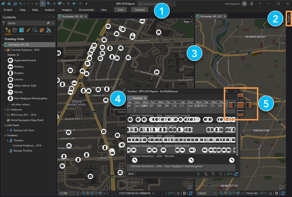

Arrange the user interface
You can arrange the elements of the user interface in various ways:
  • Drag panes and views to docking targets.
  • Stack panes and views on top of one another.
  • Float panes and views above or away from the application window.
  • Divide view space into vertical or horizontal tab groups to display more views.
ArcGIS AllSource user interfaced with customizations identified
Element
Action
Method
1
Minimize the ribbon.
Press Ctrl+F1.
2
Automatically hide a pane to minimize it when not in use.
Click Auto-Hide in the pane's title bar. Alternatively, press Alt+Minus Sign for options.
3
Make a new tab group to divide view space.
Right-click a view tab or press Alt+Hyphen for options.
4
Float a view.
Drag a view by its tab and drop it away from docking targets. Alternatively, right-click the view tab or press Alt+Hyphen for options.
5
Dock a view.
Drag a view by its tab and drop it on one of the docking targets that appear. Alternatively, right-click the view tab or press Alt+Hyphen for options.
