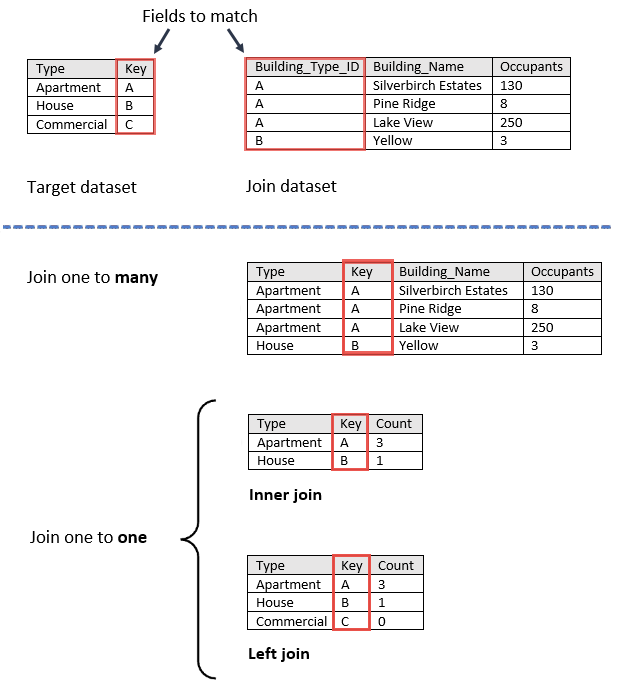

If multiple join records match the same target record, you can specify whether all the matching records will be joined (Join one to many option) or all the matching records will be summarized together (Join one to one option) as follows:
  • Join one to many—All the matching records in the join dataset will be joined to the target dataset. The output dataset will contain multiple records of the target record.
  • Join one to one—All of the matching join records will be summarized with each record in the target dataset. Only the records that have a match will be included in the summary and output. The count of joined records will be added. By default, only those target records that have the specified relationships will be maintained in the output record class (Inner join). If Left join is specified, all input target records will be written to the output record class (this is known as a left outer join).
Examples of joining one to many and one to one
In this example, the one-to-one join only includes the count.
