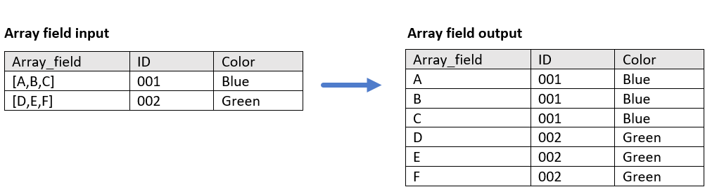

  • Array—Array field values will be returned in a field containing a row for each value in the array. The following image is an example of how an input array field will be unnested:
    Example input array values and the resulting new rows from unnesting the values

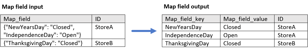

  • Map—Map field values will be returned in two new fields representing the keys and values in the map. The fields will contain the keys and values, respectively. The following image is an example of how an input map field will be unnested:
    Example input map values and the resulting new rows and fields from unnesting the values

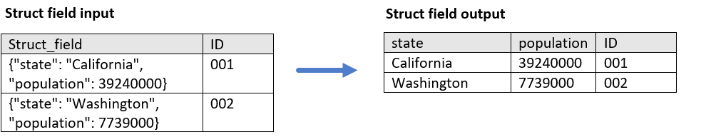

  • Struct—Struct fields will be returned as new fields for each property in the struct. The fields will contain the values for each property. The following image is an example of how an input struct field will be unnested:
    Example input struct values and the result from unnesting the values
