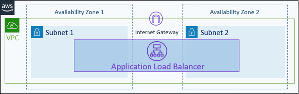

Rather than create an Elastic Load Balancer in AWS Management Console, you can use an Esri sample CloudFormation template to create an application load balancer, as shown in the following diagram:
Application elastic load balancer

The template links the imported SSL certificate to the load balancer. You can use a single application load balancer for all components of an ArcGIS Enterprise deployment (a base ArcGIS Enterprise deployment and additional federated servers).
