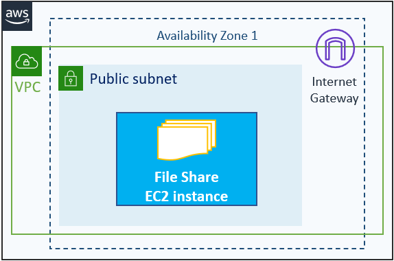

This template can create the following architecture in Amazon Web Services:
An EC2 instance in the same VPC as the rest of the deployment to use as the deployment's file share
License:
Certain icons in the diagram are used with permission from Amazon Web Services.
