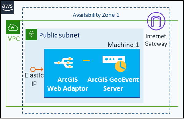

This template can create the following architecture in Amazon Web Services:
ArcGIS GeoEvent Server site on one EC2 instance with an optional Elastic IP and web adaptor
License:
Certain icons in the diagram are used with permission from Amazon Web Services.
