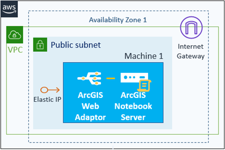

This template can create the following architecture in Amazon Web Services:
ArcGIS Notebook Server site on one EC2 instance with configuration store in cloud storage and an optional web adaptor and Elastic IP in use
