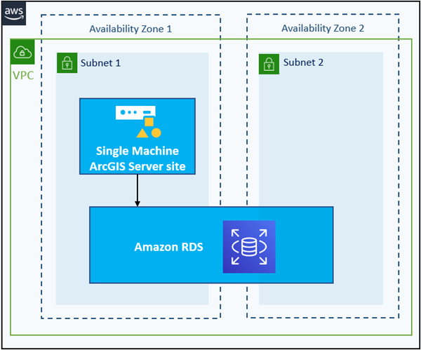

In the workflow described below, three Esri Amazon Web Services (AWS) CloudFormation templates are used to create a stand-alone ArcGIS Server site and an enterprise geodatabase registered with the ArcGIS Server site. Using this workflow, you can set up a deployment architecture as shown in the following diagram:
Follow these steps to create the architecture depicted above.
