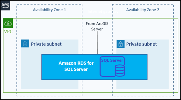

This template can create the following architecture in Amazon Web Services:
Amazon RDS for SQL Server instance created in the specified VPC and subnets and registered with the specified ArcGIS Server site
