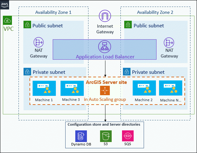

The following is an example of a type of architecture you can create on AWS using this template, with the ArcGIS Server configuration store and shared directories in cloud storage:
Highly available ArcGIS Server site contains multiple machines configured with Auto Scaling and the server configuration store and directories are in cloud storage
