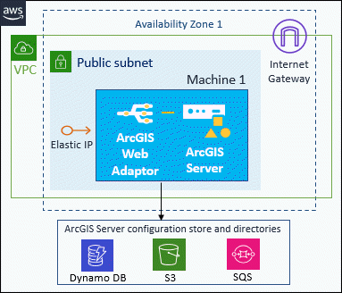

The following is an example of a type of architecture you can create on AWS using this template:
ArcGIS Server site on a single EC2 instance with optional Elastic IP and configuration store and directories in cloud storage
