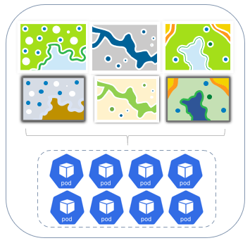

When you configure a service to run in shared mode, it shares a single set of pods with all other services of that type run in shared mode. For example, the work for every map service that is designated to use shared mode is performed by a single set of pods. The following types of services can run in shared mode:
  • Feature service
  • Tile service
  • Map service
  • Image service
When a client makes a request to a service in shared mode, the request is routed to a pod from the shared deployment that will then proceed to process the request. Using shared mode can save on resource usage costs, as the resources are shared between several services that use shared mode.
Shared map service deployment
In the example above, six individual map services are set to shared mode and are supported by eight pods in a shared map service deployment. Any traffic received by these six services can be supported by any of the pods in the shared service deployment.

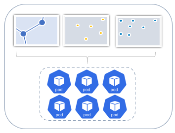

In the following example, three individual hosted feature services are supported by six pods in a shared feature service deployment.

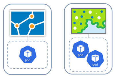

When you use dedicated mode for a service, a set of one or more pods is designated exclusively to process requests for that service. For example, when you publish a map service that is configured in dedicated mode, one map service deployment is created for this service, and it will include one or more pods dedicated to serving that map service.
A dedicated map service deployment contains a defined number of pods. Each service can be configured independently of others to handle service requests as needed. Scenarios in which services are receiving high traffic consistently are potential candidates for moving the services to using dedicated mode.
Dedicated mode deployment
In the example above, two distinct services are configured for dedicated mode; a map service is supported with one pod and another map service is supported with two pods.
