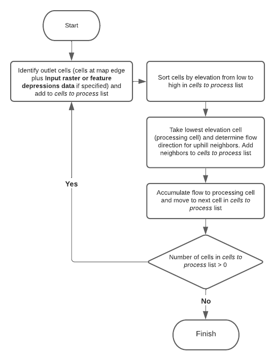

In the Derive Continuous Flow algorithm, there are two basic steps in the least-cost path approach applied to flow routing. First, valid outlets are set. Valid outlets are cells where water can flow into but not outwards. By default, outlet cells are cells at the edge of the input surface raster. If Input raster or feature depressions data is specified, cells in the input raster or feature dataset will also be marked as valid outlets from the start of the algorithm. The second step is to traverse the input surface raster and derive flow direction and flow accumulation at each cell by processing cells in order from lowest elevation to highest elevation. These two principles allow movement from the current cell to the next higher cell in the direction of the least steep uphill slope (Metz et al., 2011; Ehlschlaeger, 1989).
The following diagram shows the general logic followed. Special cases such as depression (sink) cells not explicitly specified as depressions through the Input raster or depressions data parameter and NoData are explained in the Process unknown depression cells and NoData cells in the input surface raster sections, respectively.
Algorithm in Derive Continuous Flow
Figure 1. The least-cost path algorithm for determining flow routing and accumulation, as described in Metz et al., 2011; Ehlschlaeger, 1989, is shown.

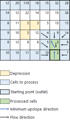

The algorithm continues in the same manner, identifying neighboring cells to the current processing cell following the direction of the minimum upslope. The next iteration of the algorithm is shown in Figure 6.
Processing next cell in the direction of the minimum upslope
Figure 6. The next iteration is shown. As in Figure 5, cells highlighted in blue are cells that can potentially be processed next. The next cell to process in this diagram is 3, colored green. Black arrows correspond to flow direction, and blue arrows correspond to the least-cost path direction.

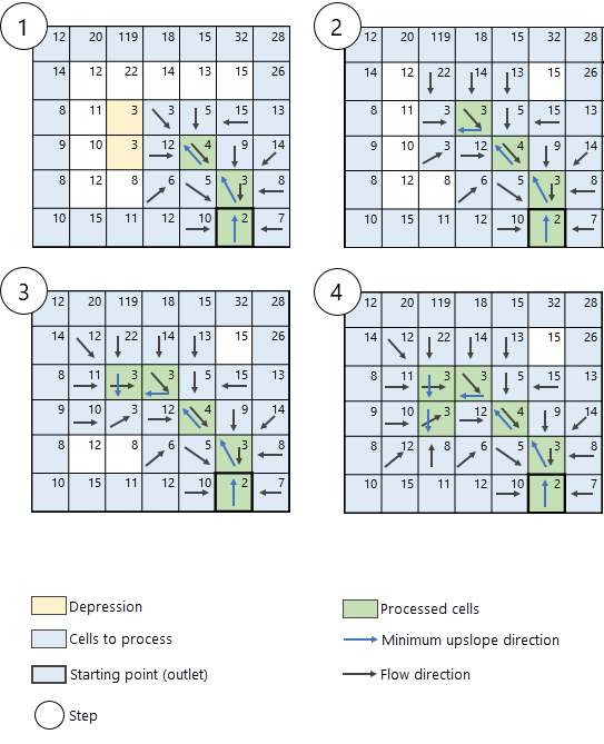

Depression (or sink) cells can be individual cells or a group of cells whose neighbors have a higher elevation value than that of the processing cell or group of cells. If these are not included in the Input raster or feature depressions data parameter, they will be unknown depression cells to the tool. Under this scenario, if an unknown depression cell or group of cells are encountered, the path follows the steepest descent (instead of following the lowest uphill neighboring cell) until reaching the bottom of the depression, setting flow direction and accumulation along the depression path. This process is shown in Figure 7.
Processing unknown depression cells
Figure 7. The sequence of processing each cell within the depression, from left to right, is shown. Flow direction and accumulation is determined as each cell within the depression is processed. Processing direction through the depression is toward the steepest descent, instead of following the lowest uphill neighboring cell.

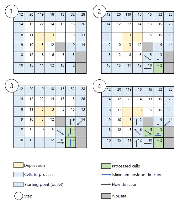

NoData cells in the input surface raster are cells whose value is not known. These cells can exist in the surface raster and can be encountered during the Derive Continuous Flow algorithm. If this is the case, they are not processed and the algorithm passes around them, as shown in Figure 8.
Algorithm steps when NoData cells exist
Figure 8. NoData cells within the input surface raster are ignored by the Derive Continuous Flow tool. Exterior NoData cells push the input surface raster boundary to the neighbors with valid data values. The rest of the calculations to determine flow direction and accumulation remain the same.
