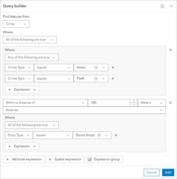

Expression group
To create a more complex query, you can use expression groups to group multiple expressions. The way in which you group the expressions determines what you are finding. You can create up to three levels of grouping.
For example, you can use expression groups to further refine the crime incident filter described above. To show both arson fire and theft incidents reported within a distance of 100 meters of a donut shop, you can create an expression group to find arson fires or theft incidents. Within that group use the Any of the following are true option. Then, outside of the group, add a spatial expression for finding features within 100 meters of donut shops.
Group expression querying for arson and theft incidents within 100 meters of donut shops
