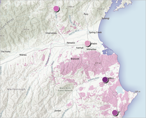

An agricultural official in the Marlborough region of New Zealand is tasked with identifying areas near commercial campgrounds where seeds from the invasive Nassella tussock plant may be caught on shoes and clothing and spread to other areas. The official uses Summarize Nearby to summarize the total area where Nassella tussock is present within a 1.5-kilometer distance of commercial campgrounds.
Summarized areas of Nassella tussock sightings within a 1.5-kilometer distance of campgrounds

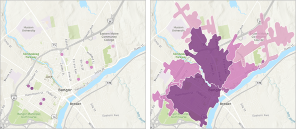

  • Return output as bounding areas specifies whether an output layer of the bounding areas is created. If checked, the output is a polygon layer representing the bounding areas and the summarized statistics. If unchecked, the result layer is the same as the input layer but includes the summarized data.
    Return output as bounding areas parameter
    The difference in result layers is shown when bounding areas are not returned (first image) or are returned (second image).
