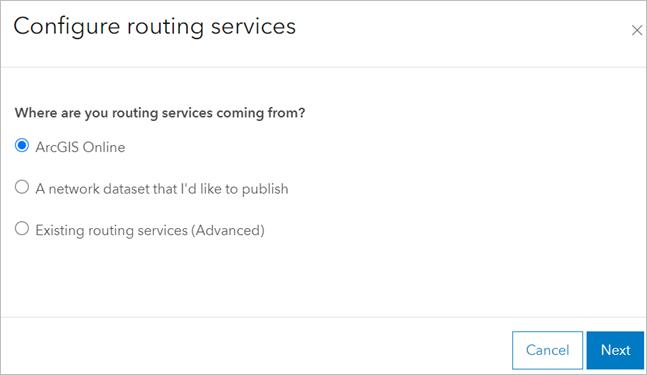

  5. Click Configure routing services and choose one of the three methods to configure routing services.
    Configure routing services dialog box

  1. On the Configure routing services dialog box, select the ArcGIS Online option, and click Next.
