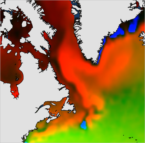

  • Linear—The linear trend information from the model is converted to RGB. Use this option to visualize the slope and intercept coefficients for a linear trend model.
    Increasing (positive) slope values are converted to red, decreasing (negative) slope values are converted to blue, and intercept values are converted to green. The intercept is the modeled pixel value at the time of the first slice. In the image below, yearly ocean temperatures in the Labrador Sea are rising and are displayed in red, while coastal waters just off the southeast coast of Greenland are decreasing and are displayed in blue.
    Linear trend results in RGB
