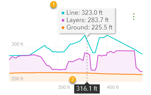

Note:
Whether a profile type generates elevation depends on the nature of the line you draw or select. In the image below, the selected line additionally crosses 3D objects, so elevation is calculated for all three types.
  • The Ground profile is always generated if there is elevation where you draw the line.
  • When you draw a line, the Line profile is automatically disabled.
The following image is an example of the display when you hover over the chart:
Elevation profile chart displaying Ground, Layers, and Line elevation Elevation profile chart displaying Ground, Layers, and Line elevation
Elevation for the available profile types.
Horizontal distance from the start of the line.
