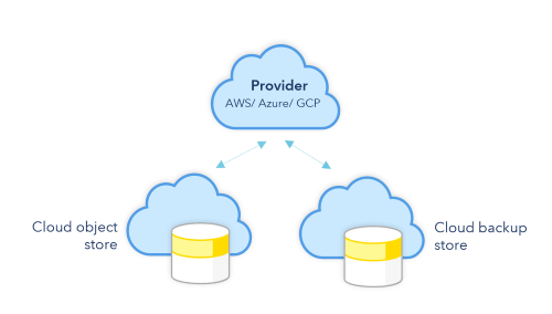

A cloud provider is the parent object that can contain several associated cloud services. The providers currently supported by ArcGIS Enterprise on Kubernetes are Amazon Web Services (AWS), Microsoft Azure, and Google Cloud Platform (GCP). A single cloud provider can have multiple cloud services as child objects, as shown in the following image:
Provider for cloud services

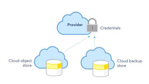

If you set the object store to use a cloud provider when configuring an organization, the associated credential type and keys are appended to the provider-level resource. This allows for the use of a single credential for numerous cloud services, as shown in the following image:
Provider credentials for cloud services

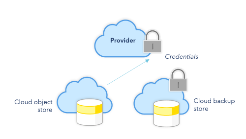

If a cloud service does not have specific credentials, it uses provider-level credentials by default, as shown in the following image:
Default for cloud services without specific credentials
