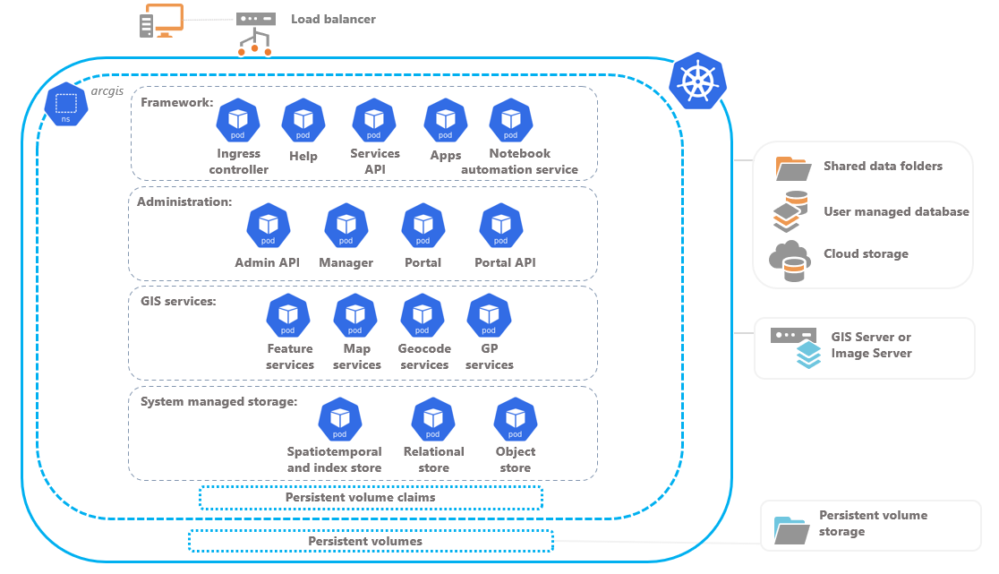

ArcGIS Enterprise on Kubernetes foundational aspects are described below. The diagram illustrates a Kubernetes cluster containing a namespace called arcgis. The namespace contains four categories of pods that represent various system functions. The diagram does not represent a complete list of pods or requirements; rather it depicts an overview of how the system is organized.
Framework
Framework pods support your organization's workflows and provide information for members of the organization to learn about the system through help documentation. These pods can also be scaled in their respective system deployments using ArcGIS Enterprise Manager or ArcGIS Enterprise Administrator API.
Pod name |
Purpose |
Ingress controller |
Single point of entry into the Kubernetes cluster and directs traffic across the cluster |
Help |
Step-by-step and conceptual documentation to deploy, configure, and use ArcGIS Enterprise on Kubernetes |
Services API |
APIs for GIS, system, and utility services that support publishing, caching, and analysis workflows |
Apps |
Foundational support for embedded apps in the organization |
Notebook automation service |
Manages notebook service deployments to support notebook authoring and automation |
Administration
Administrative pods provide the initial framework to create an ArcGIS Enterprise organization. Once your organization is up and running, you can scale these pods in their respective deployments using ArcGIS Enterprise Manager or ArcGIS Enterprise Administrator API.
With ArcGIS Enterprise Manager, administrators can monitor and manage various aspects of the organization. Administrators are provided with an active view of the organization through monitoring tools for system health, logs, and other critical information. ArcGIS Enterprise Administrator API is fundamental to the organization. It manages the life cycle of the ArcGIS Enterprise components and aids in operations across the organization.
Learn more about administrative resources and workflows
Pod name |
Purpose |
ArcGIS Enterprise Administrator API |
APIs for administrative and automation aspects of the ArcGIS Enterprise organization. |
ArcGIS Enterprise Manager |
Initially used as a setup wizard to create an ArcGIS Enterprise organization. Once the organization is configured, ArcGIS Enterprise Manager is used to manage, monitor, and secure the organization. |
ArcGIS Enterprise organization |
User experience that supports sharing and item and member management workflows. |
Portal (sharing) API |
APIs that support sharing, item management, and member management workflows. |
GIS services
GIS services enable the geospatial capabilities of your organization. GIS services include map, feature, and geocode services as well as hosted map and feature services. GIS services that reference user managed data stores require an active connection to a registered data store. Hosted services are published using system storage. These pods, as well as those for system services and utility services, can be scaled in their respective service deployments.
Additionally, you can federate additional server sites from Windows and Linux environments to add capabilities to your system.
Pod name |
Purpose |
Feature services |
Supports editing workflows in maps and apps. |
Map services |
Makes maps, features, and attribute data available in many types of applications. |
Geocode services |
Supports workflows to search for and locate addresses and places on a map. |
GP services |
Supports service tools for mapping and feature services. |
Notebook services |
Supports workflows to publish notebooks as web tools. |
System storage
ArcGIS Enterprise on Kubernetes deploys and manages system storage. System storage can be provided using StatefulSets that bind to one or more persistent volumes. Alternatively, some system storage types can be provided by integrating with a cloud service. Information about each type of system storage data store is summarized in the following table:
Data store |
Purpose |
Supports cloud service integration |
Object store |
Stores uploaded and saved content, hosted tile and image layer caches, and geoprocessing output. |
Yes |
Relational store |
Stores hosted feature data and administrative aspects such as customization and configuration settings. Two relational stores are configured: primary and standby. |
Yes |
Spatiotemporal and index store |
Stores logs and indexes as well as hosted feature data. |
No |
When system storage uses persistent volumes, administrators can configure the storage classes that are used by the persistent claims allowing control over the size and kind. Cloud providers typically have a variety of volume controllers that can provision various types of volumes from network shares to block storage or disk.
At this release, system storage pods cannot be reallocated resources or scaled. Pod replicas, requests, and limits are predefined by the deployment's architecture profiles.
