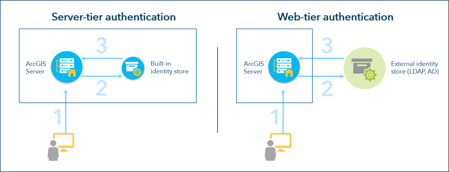

As the below diagram illustrates, server-tier authentication takes place entirely within the server site, while web-tier authentication relies on the external identity store to validate the user's credentials.
The built-in identity store is managed in ArcGIS Server Manager when it is configured. Information about users and roles is kept in the server's configuration store, and only ArcGIS Server has access to that information. Users authenticate to the identity store using tokens—strings of encrypted information that contain the user's name, the token expiration time, and other proprietary information.
Many types of web-tier authentication systems can be configured with stand-alone ArcGIS Server sites. These include Lightweight Directory Access Protocol (LDAP) directories, public key infrastructure (PKI)-based client certificate authentication, and Integrated Windows Authentication (IWA).
