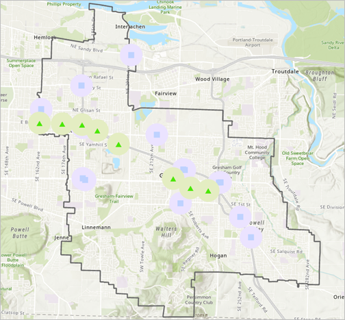

A development company plans to construct a new mixed-use development in an urban center. The development must be conveniently located within a quarter mile of shops, restaurants, or a light rail stop. The Create Buffers tool can be used to create a buffer around the potential development sites to determine whether they fit this criteria.
Quarter-mile buffers around potential development sites

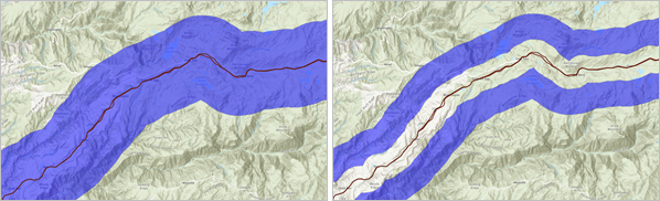

  • Multiple-distance buffer shape specifies whether the outer buffers should include the areas within the smaller buffers when multiple values are provided in the Distance values parameter. This parameter is only available if Dissolve is chosen for Overlap policy. The Multiple-distance buffer shape parameter options are as follows:
    • Overlapping disks—Larger buffers include areas within one or more smaller buffers. This is the default.
    • Distinct rings—Larger buffers do not include areas within one or more smaller buffers.
    Buffers created using overlapping disks and distinct rings
    The difference in the shape of the outer buffer in the result layer is shown when using overlapping disks (first image) or distinct rings (second image).
