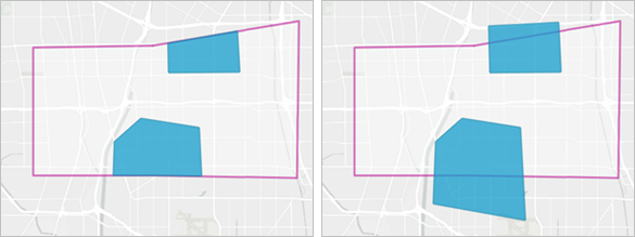

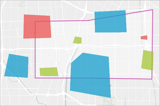

    The following images show the difference in results using the Include only the parts of features that meet the criteria parameter, given the following input data:
    • A polygon layer colored in blue, red, and green.
    • A polygon layer that is transparent with a pink outline.
    Input colored polygons in blue, red, and green, and a single transparent polygon with a pink outline
    This example finds the blue polygons where they intersect with the transparent polygon with the pink outline. The following two outputs show the difference in results when Include only the parts of features that meet the criteria is checked (first image) and unchecked (second image):
    Results of returning only portions of the features (first image) and returning only full features (second image)
