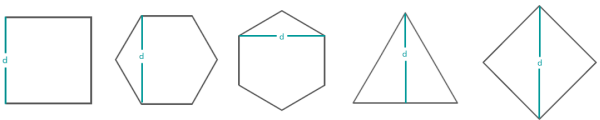

Bin size measurement specifies how the size of the bin will be defined. The options are the following:
Area—The size of the bin will be defined by its area.
Distance—The size of the bin will be defined by the distance between two vertices of the specified Bin shape type value.
Bin size is a numeric value that defines the size of the bins in the tessellation.
Bin size units specifies the units of the Bin size value. If Distance is selected as the Bin size measurement value, the units can be miles, nautical miles, yards, feet, kilometers, or meters. If Area is selected as the Bin size measurement value, the units can be square miles, acres, square yards, square feet, square inches, hectares, square kilometers, or square meters.

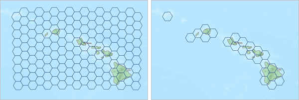

Only keep intersecting tessellations specifies whether the tessellations will cover the entire extent of the extent layer or only cover the areas where the tessellations intersect with features in the extent layer. If unchecked (default), all generated bins will be returned. If checked, only bins that intersect features from the extent layer will be returned.
The difference in result layers is shown when all tessellations are returned (first image) or only intersecting tessellations are returned (second image).

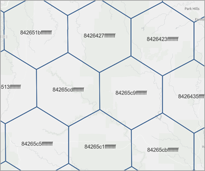

The tool outputs a layer in which the specified extent contains a grid of cells with the selected shape and size. The polygon layer will include a GRID_ID field, with the following values:
For H3 hexagon bin types, the
GRID_IDvalues will be a unique hierarchical index for each cell.

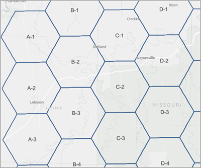

For all other bin types, the
GRID_IDfield will be a unique ID for each feature. The format for the ID field is A-1, A-2, B-1, B-2, and so on, in which each row is represented by a number, and each column by a letter.
