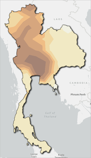

A GIS analyst has a dataset with air quality points across Thailand. The Interpolate Points tool can be used to predict air quality values across the country to create an air quality surface.
Map of air quality in Thailand
