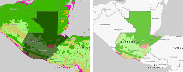

A field scientist requires a dataset showing the ecoregions in Guatemala, but only has access to a global layer. The Intersect overlay type in Overlay Layers can be used to clip the global layer to the Guatemala country boundaries.
Ecoregions clipped to Guatemala country boundaries
The first image shows the input layer (global ecoregions) and overlay layer (Guatemala country boundaries). The second image shows the output feature layer where the ecoregions intersect the Guatemala boundaries.
