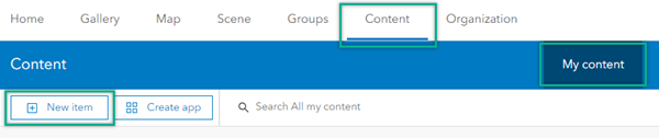

  2. Open Content > My content, click New item, and click Your device.
    Add new a item.

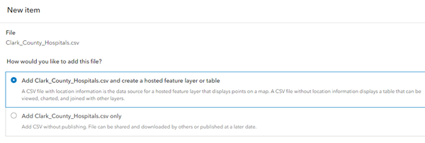

  4. Choose Add <file name> and create a hosted feature layer or table.
    Create a hosted feature layer.

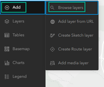

  3. On the Contents (dark) toolbar, click Add and click Browse layers .
    Browse layers

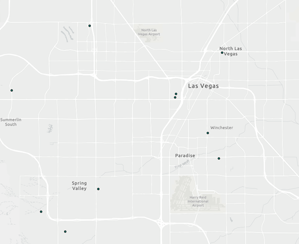

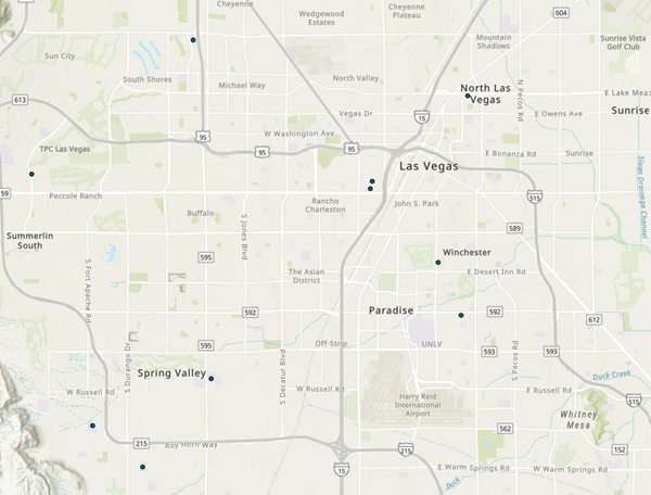

    The new layer appears on the map.
    Data visualized on the map

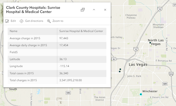

    The map displays the locations of the hospitals listed in the .csv file as points. Each hospital is considered a feature in the layer. You also have access to the descriptive information, or attributes of the data, by viewing pop-ups for features on the map.
  6. On the map, click any point.
    A pop-up window appears with information, or attributes, about the hospital from the layer's table.
    Pop-up with information for Sunrise Hospital & Medical Center
  7. Close the pop-up.

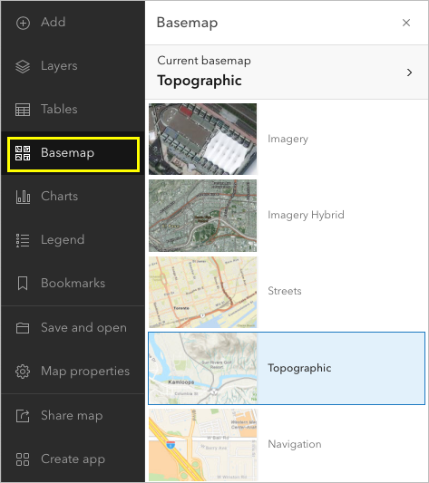

  1. On the Contents (dark) toolbar, click Basemap.
    Basemap pane
    The Basemap pane appears. The Topographic basemap is selected.

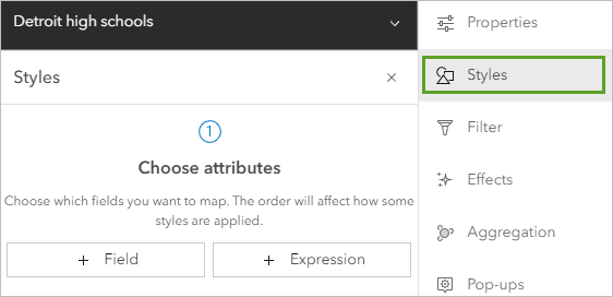

  3. On the Settings (light) toolbar, click Styles.
    Styles pane
    Note:
    If the Settings toolbar is unavailable, click Layers on the Contents toolbar and click the hospitals layer to select it.
    The Styles pane appears. Currently, the style is based only on the data's location. You'll configure the symbols to convey both location and one of the data's attributes.

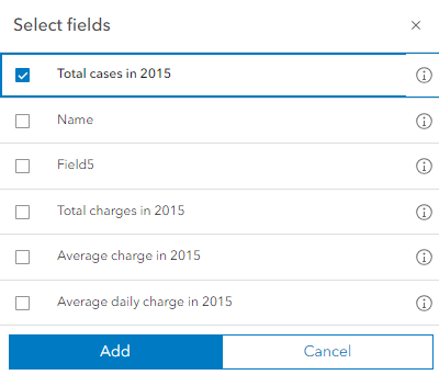

  4. In the Styles pane, click Field. In the Select fields menu, choose Total cases in 2015 and click Add.
    Select fields menu

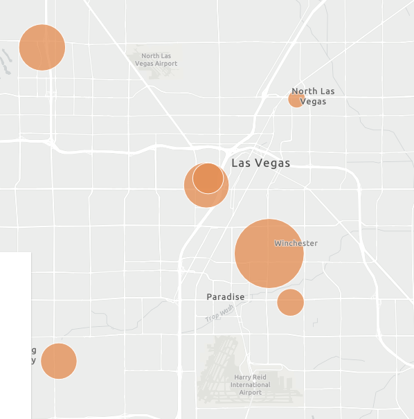

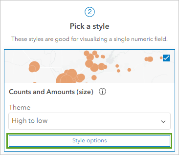

    The options under Pick a style update to reflect choices that are suitable for the Total cases in 2015 field. Counts and Amounts (size) is selected and the map updates to reflect this style. This style reveals some new patterns in the data. The larger the circle, the more patients that hospital admitted in 2015.
  5. On the Counts and Amounts (size) card, click Style options.
    Style options button

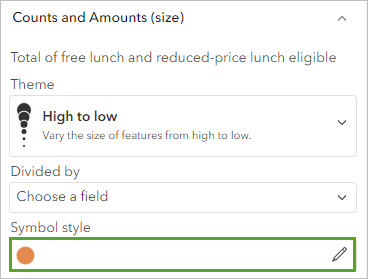

  6. In the Counts and Amounts (size) pane, click Symbol style.
    Symbol style
    The Symbol style window appears. You'll adjust the symbol's properties so circles can be seen even when overlapping.

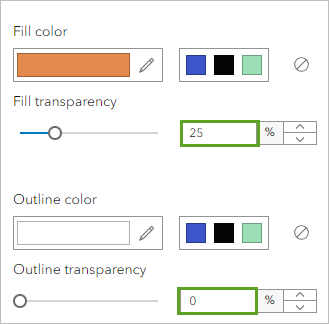

  7. Set Fill transparency to 25 and Outline transparency to 0.
    Transparency settings
    The symbols on the map update. It is now easier to see overlapping circles.

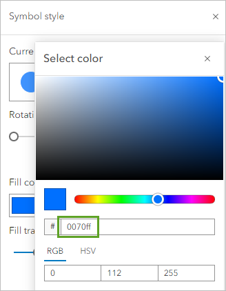

  8. Click Fill color. In the Select color window, type 0070FF for the Hex value.
    The color of the map symbols changes to blue.
    Symbol color set to blue

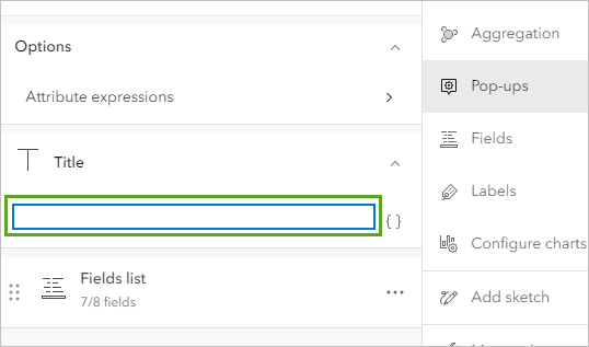

  2. In the Pop-ups pane, click Title and erase the text in the box.
    Blank Title field in the Pop-ups pane

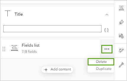

  3. Next to Fields list, click the Options button and click Delete.
    Options and Delete buttons

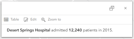

  4. Click Add content and click Text.

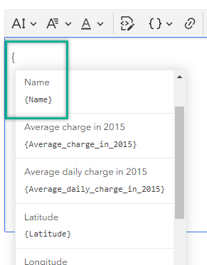

  5. In the text editing window, type {. In the menu that appears, click Name.
    Bracket and Name field

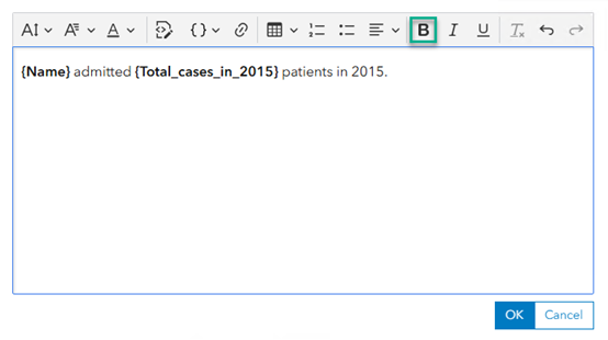

  6. After {Name}, type admitted {Total_cases_in_2015} patients in 2015.
    You can add fields by typing their names inside curly brackets or by choosing them from the list that appears when you type a curly bracket.
  7. Use the Bold button on the toolbar to add bold formatting to {Name} and {Total_cases_in_2015}.
    Bold button in text editor
  8. Click OK.
    The sample pop-up replaces the field names with the attribute values for the selected feature.
    Final pop-up

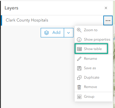

  10. In the Layers pane, click the Options button next to hospitals layer and click Show table.
    Options and Show table buttons
    The layer's table appears below the map.

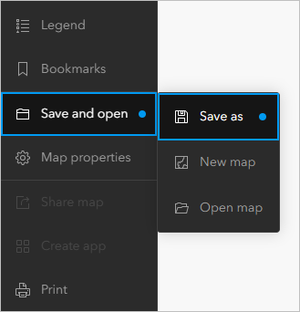

  1. On the Contents (dark) toolbar, click Save and open and click Save as.
    Save and open menu
    The Save map window appears.

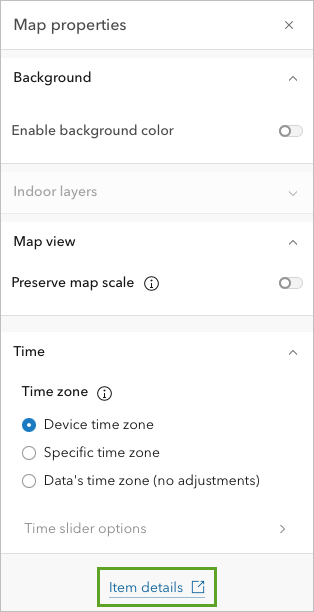

  5. On the Contents (dark) toolbar, click Map properties. In the Map properties pane, click Item details.
    Item details link in the Map Properties pane
    Your map's item page opens in a new window. The item details are missing important attribution and descriptive information that you should fill in before you share the map. For example, you should give credit to the data providers.

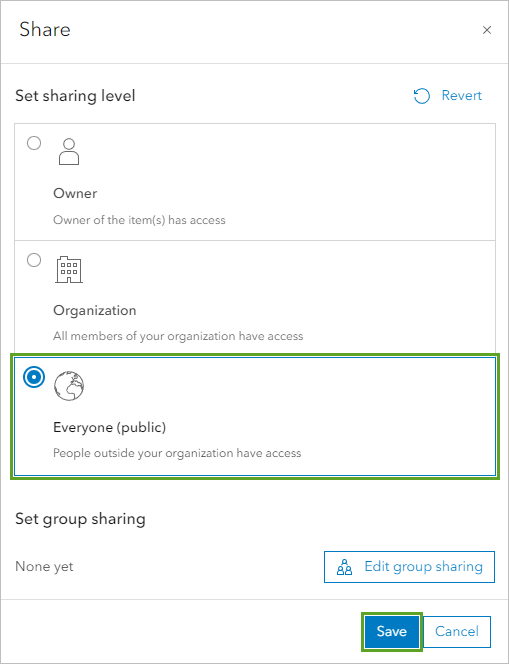

  1. In Map Viewer, click Share map on the Contents (dark) toolbar.
  2. In the Share window, choose Everyone (public) and click Save.
    Share window
    The Review sharing window appears. You must set the sharing level for the layer as well as the map.
  3. In the Review sharing window, click Update sharing.
