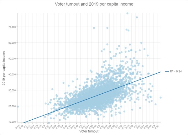

The scatterplot below visualizes the relationship between voter turnout in the 2016 United States election and the 2019 per capita income.
  • X-Axis—Voter turnout
  • Y-Axis—2019 per capita income
There is a positive relationship between voter turnout and per capita income.

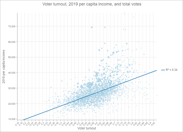

The symbol size can be set to Proportional to show the total votes.
Proportionally sized points visualize total votes.
