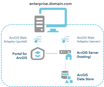

Migrate a single-machine deployment
If you are migrating a single-machine base deployment, you can use the same name between the new and old environments using the \etc\hosts file. There are two common patterns with single-machine deployments:
The fully qualified domain name of the machine matches the host in the URL used to access the deployment.
The fully qualified domain name of the machine does not match the host in the URL used to access the deployment. Users access the deployment through an alias or CNAME record.
How you add entries into the \etc\hosts file differs depending on your environment.
Migrate when the machine host name matches the organization URL
In this scenario, ArcGIS Enterprise is installed on a machine named enterprise.example.com and is running on Windows Server 2016. The host name of the machine matches the host name of the organization URL.

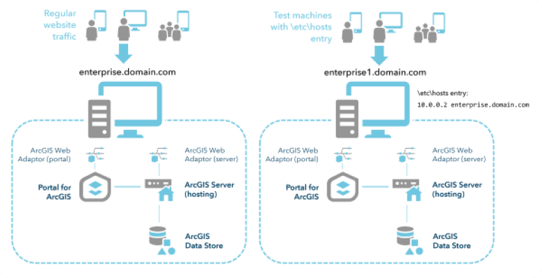

To migrate this type of environment, complete the following steps:
Acquire your new machine.
This can be a virtual machine or physical machine.
In this example, the machine's host name is
enterprise1.example.com, its IP address is 10.0.0.2, and it's running Windows Server 2022.On the new machine, update the
\etc\hostsfile to resolve the IP address of the new machine toenterprise.example.com:10.0.0.2 enterprise.example.comThe
\etc\hostsfile must be updated before you install any software on the new machine.Repeat step 2 on any other machine you might use to test and validate the new system.
Note:
This does not include the existing production machine.
Install and configure ArcGIS Enterprise components.
Once the environment is configured, you can only reach the new environment through the
enterprise.example.comhost name from the machine itself or from any other machine that you've added the entry to. Any machines without the entry will resolveenterprise.example.comto your original production environment through DNS.
Enable read-only mode in your existing deployment.
Create a backup using the WebGISDR tool.
It is important to consider timing when creating a backup. Once you create a backup using the WebGISDR tool, only the content present in the deployment will be moved over. If you did not enable read-only mode during step 1, this is especially important to consider. It's recommended that you run a backup during a period of downtime to prevent the loss of any new content.
Restore the backup on the new machine with the WebGISDR tool.
This will create a replica of the existing deployment on the new machine.
Validate that users, content, groups, and services are accessible on the new machine, using any machine on which you've added the
\etc\hostsentry.Only machines with the
10.0.0.2 enterprise.example.comentry in the hosts file will resolveenterprise.example.comto the new machine. Otherwise, those requests will go to the original machine.Once the environment has been validated and you're ready to switch over, update the DNS to resolve
enterprise.example.comto the new machine.All requests to
enterprise.example.comwill now resolve to the new machine, including all content from the old environment.Remove the
10.0.0.2 enterprise.example.comentry from the\etc\hostsfile on the new machine and on any other machine to which you added it.

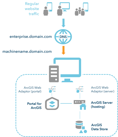

Migrate when ArcGIS Enterprise is accessed through an alias
In this scenario, ArcGIS Enterprise is installed on a machine named machinename.domain.local and is running on a Windows Server 2016 operating system. Your DNS stores a CNAME, or alias, for the machine as enterprise.example.com.
Members access ArcGIS Enterprise in the following ways:
Organization members access as follows:
Content and items:
https://enterprise.example.com/portalService endpoints:
https://enterprise.example.com/server/rest
Organization administrators and publishers access as follows:
ArcGIS Server Manager:
https://machinename.domain.local:6443/arcgis/managerArcGIS Portal Administrator Directory:
https://machinename.example.com:7443/arcgis/portaladminArcGIS Portal Directory:
https://machinename.example.com:7443/sharing/rest
To migrate to this type of environment, complete the following steps:

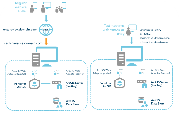

newmachine.domain.local, its IP 10.0.0.2, and it's running Windows Server 2022.On the new machine, update the
\etc\hostsfile to resolve the IP address of the new machine tonewmachine.domain.localas well asenterprise.example.com:10.0.0.2 newmachine.domain.local enterprise.example.comThe
\etc\hostsfile must be updated before you install any software on the new machine.Listing the local host name into the
\etc\hostsfile first ensures that the software will store the name in configuration files, rather than the DNS alias. Adding the DNS alias ensures the deployment can be configured with the DNS alias without impacting production.Repeat step 2 on any other machine you will use to test and validate the new system.
Note:
Install and configure ArcGIS Enterprise components. Use the DNS alias when registering the Web Adaptor.
Validate that users, content, groups, and services are accessible on the new machine, using any machine on which you have added the

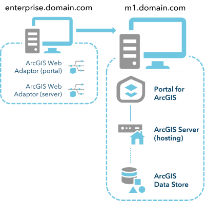

Migrate a multimachine deployment
If you have a distributed environment, you must modify the \etc\hosts file to ensure that the component acting as the front end for your deployment (its instances of ArcGIS Web Adaptor or reverse proxy) is resolving to the original name.

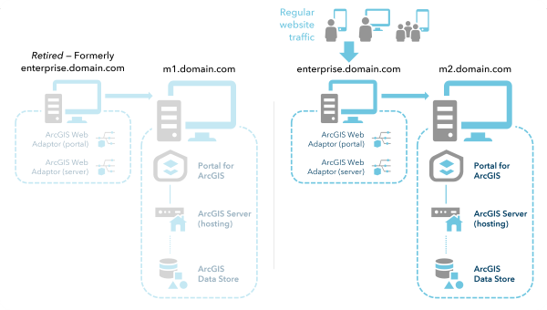

In this scenario, ArcGIS Enterprise components are distributed across two machines, both running a Windows 2016 operating system:
Two instances of ArcGIS Web Adaptor are installed on a machine named
enterprise.example.com.Portal for ArcGIS, ArcGIS Server, and ArcGIS Data Store are installed on a machine named
m1.example.com.
The objective for this scenario is to migrate to a newer operating system, for example: Windows Sever 2022.

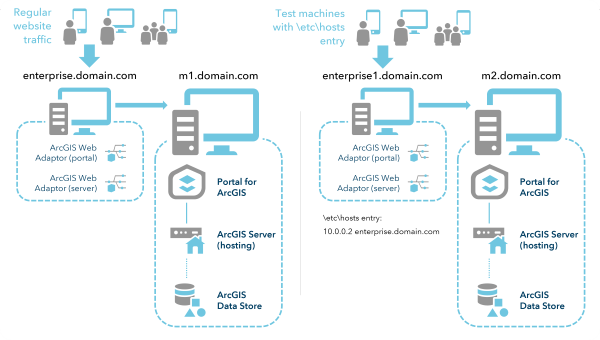

To migrate an environment with this scenario, complete the following steps:
Acquire two new machines, one to host instances of ArcGIS Web Adaptor and the other to run the rest of the components.
The only IP address that matters in this case is the Web Adaptor machine, because the only settings that must match between deployments are
https://enterprise.example.com/portalandhttps://enterprise.example.com/server. The IP address of the new Web Adaptor machine in this example is 10.0.0.2.On each new machine, update the
\etc\hostsfile to resolve the IP address of the Web Adaptor machine toenterprise.example.com:10.0.0.2 enterprise.example.comInstall the two ArcGIS Web Adaptor instances on
enterprise1.example.com.Install Portal for ArcGIS, ArcGIS Server, and ArcGIS Data Store on
m2.example.com.Create the portal and server sites.
Register the Data Store to the server site.
Configure the instances of ArcGIS Web Adaptor on
enterprise1.example.comby reaching the configuration page throughhttps://enterprise.example.com/portal/webadaptorandhttps://enterprise/example.com/server/webadaptor.The requests will be resolved to the new Web Adaptor machine (which is actually
enterprise1.example.com) through the\etc\hostsfile.
Federate your server site with the portal, and ensure that you use
https://enterprise.example.com/serveras the services URL.The admin URL can be either
https://enterprise.example.com/serverorhttps://m2.esri.com:6443/arcgis.Enable read-only mode in your existing deployment.
It is important to consider timing when creating a backup. Once you create a backup using the WebGISDR tool, only the content present in the deployment will be moved over. If you were unable to enable read-only mode during step 1, this is especially important to consider. It's recommended that you run a backup during a period of downtime to prevent the loss of any new content.

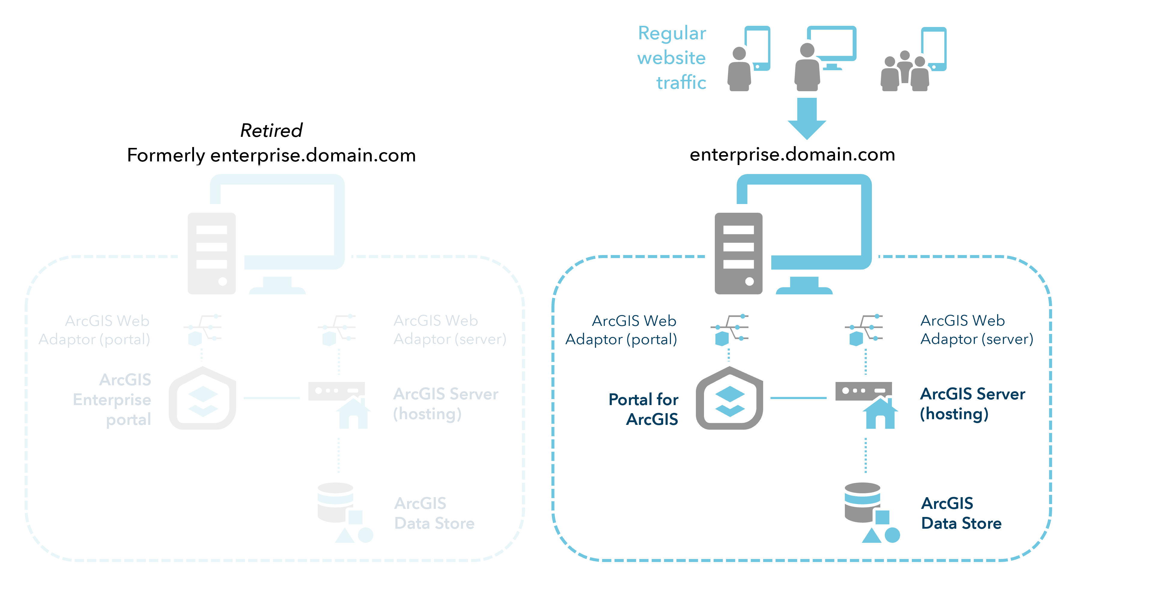

10.0.0.2 enterprise.example.comentry in the hosts file will resolveenterprise.example.comto the new machine. Otherwise, those requests will go to the primary machine.Once the environment has been validated and you're ready to switch over, update your DNS to resolve
enterprise.example.comto the new machine hosting the Web Adaptor and remove the\etc\hostsentry on that machine as well as onm2.example.com.All requests to
enterprise.example.comwill now resolve to the new machine, which will direct traffic tom2.example.com. There, you will be able to work with all the content from your old environment on your new machines.
