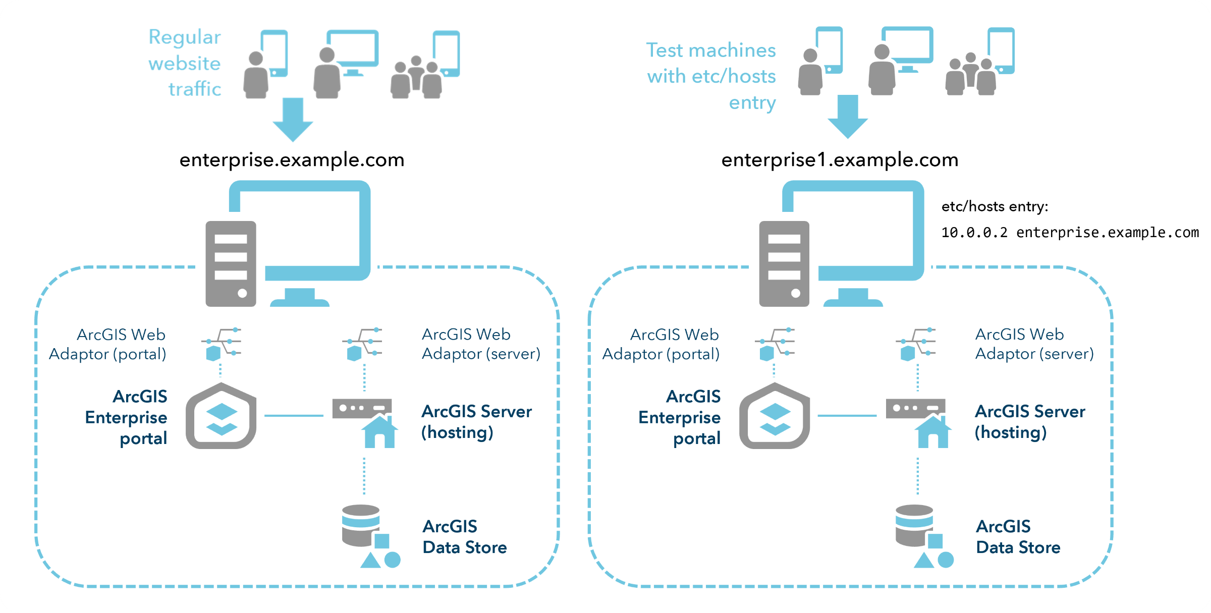

Option 1: Modify the \etc\hosts file
You can use the local \etc\hosts file on the new machines to control how the public URLs resolve during the migration. This allows the fully qualified domain name (FQDN) of the public URL to resolve to a different endpoint, such as a new Web Adaptor or reverse proxy, without updating DNS.
The \etc\hosts file resolves hostnames by mapping IP addresses to hostnames. Entries in this file take precedence over DNS and apply only to the machine on which they are configured.
The \etc\hosts file is located at C:\Windows\System32\drivers\etc.
Resolve hostnames with the \etc\hosts file
For example, the primary environment is accessed using the public URL enterprise.example.com, which resolves through DNS. On the new machines, you can add an entry to the \etc\hosts file that maps the IP address of the new environment to an alternate hostname, such as enterprise1.example.com.
When enterprise1.example.com is accessed, the \etc\hosts file resolves the hostname locally to the IP address of the new environment. If a web server is running on the machine, it can be reached through enterprise1.example.com, while enterprise.example.com continues to resolve to the primary environment through DNS.

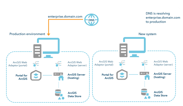

Option 2: Redirect traffic until the software is configured
If you are able to redirect traffic away from your production environment for a short period of time, configure the component that is directing traffic to your production environment to send traffic to your non-production environment.
This may mean that you need to re-register the Web Adaptor with the new machines or update your reverse proxy or load balancer to send traffic to the new machines within the non-production environment. This only needs to be done when you are ready to federate and set the server as the hosting server.
This approach may be considered the easiest, but it can present issues for organizations who cannot easily make changes to their production environment.

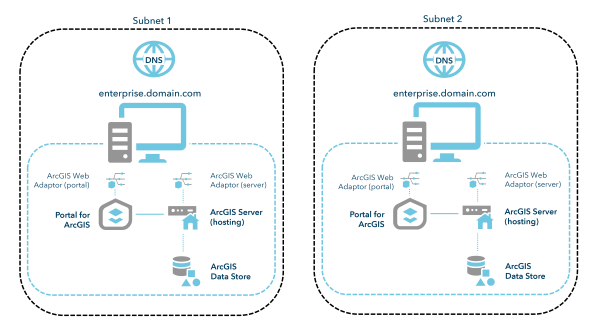

Option 3: Configure your DNS so that the standby machines resolve the organization URL to a different IP address than the primary machines
Alternatively, you can configure the standby environment DNS to resolve the FQDN of the public URLs differently depending on if you're on the primary machines or the standby machines. This is commonly referred to as a split DNS or split-horizon DNS. An additional Web Adaptor, reverse proxy, or load balancer is required for this method, as the public URL has to be accessible to federate the portal and server site.
This approach is functionally equivalent to modifying the \etc\hosts files, but managed through DNS rather than an \etc\hosts file.
