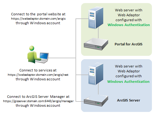

The diagram below shows a federated portal and server architecture with IWA successfully configured.
Architecture for IWA on a federated server
