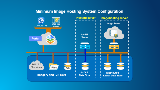

Minimum image hosting system
In this implementation, the image hosting operations are executed on an ArcGIS Image Server site configured as the image hosting server. The ArcGIS Image Server site does the work of processing requests, storing the results, and returning results to members in the Portal for ArcGIS site.
A diagram of the minimum image hosting system is shown below.
Minimum Image Hosting Configuration
