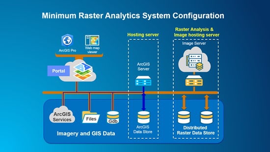

If an organization has resources and limited conflicts in terms of competing raster analysis processing and image service distribution resources, the raster analysis server and image hosting server functionality can be combined and hosted on one server. In this implementation, the raster analysis and image processing operations are executed on an ArcGIS Image Server site configured as the raster analysis server, while the results are managed and published through the same ArcGIS Image Server site. The ArcGIS Image Server site does the work of processing analytics requests, storing the results, and returning results to members in the Portal for ArcGIS site.
A diagram of the minimum raster analysis system is shown below.
Minimum raster analysis deployment
